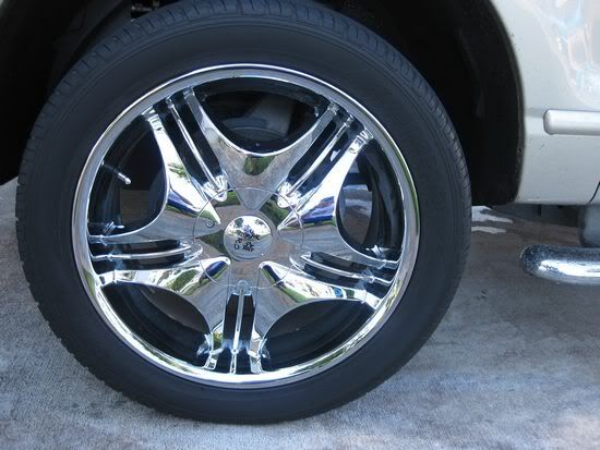

                          some pics for you to see:
                          here is the tire clean and dry:

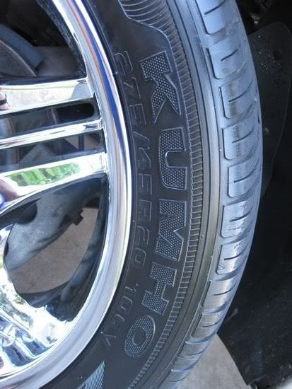

                          close up:
                          after the first coat:
                          Not too impressed by what one pass does. Also, a better sponge would be nice!
                          2nd coat:
                          3rd coat:
                          4th coat...yes, a 4th!
                          Didn't get one up close. Ill take another tomorrow. I found that the best way to apply is to make sure you have plenty on the sponge, then wipe briskly. Seeing white is okay I noticed because it dries even and clear. Swipe test to ensure that it's dry, then the next coat.
