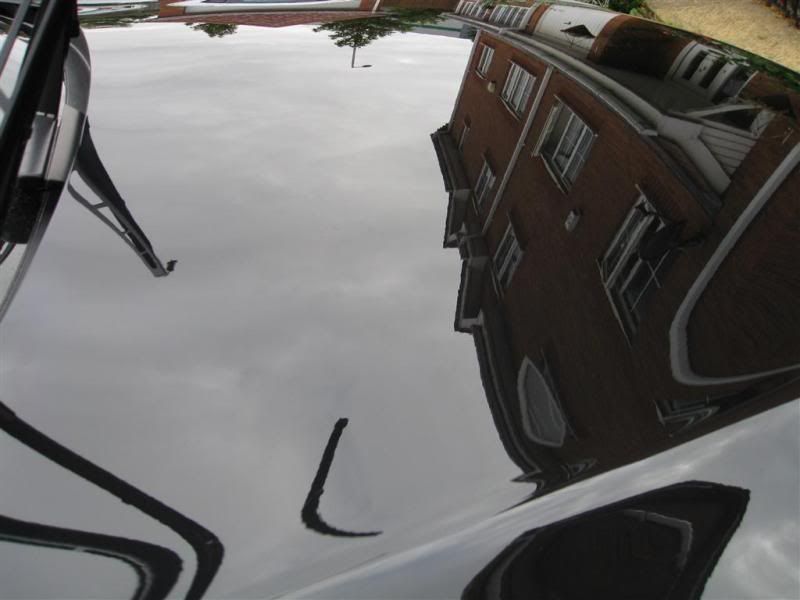

                        Sorry for the bad picture, pretty useless camera with pretty useless lighting. But you can see those little "pits".
                        Those long scratch lines are from my mrs running her fingernails lightly across it after I've waxed it. I waxed on NXT 2.0, followed by #26 paste. Should it leave a scratch line like that?

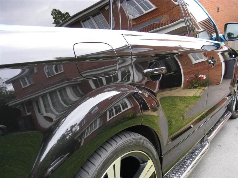

                          That car took 3 days on the paint to get it into that shape. The paint was matted and had every defect going. How I did it:
                          "Failing to prepare is preparing to fail"
                          From the off you have to be in the right mental state and not cut any corners. Youstatrt off by giving it a good wash with a deep cleaning, degreasing shmpoo and snow foam. You then dr the car and take stock of the paint and defects in front of you. Next you hit the paint with an IPA solution, this will remove old polish and waxes. The you hit it with a tar remover to remove the black spots. This also has the effect of removing mor stubborn waxes and polishes. The, and possibly one of the most overlooked parts and something Megs don't do, is to hit the car with a de-ironiser. This removes ferrous and mettalic particles. The effect can be quite staggering:
                          Then you hit the car with a clay. After all that you can safely say the car is free from decontaminates. A further wash is probably in order to remove all the chemicals.
                          On the black vehicle I hit the majority of the body panels with a cutting compound (Menzerna s500) twice, with the boot hitting it 4 times. I then followed it up with Menzerna Super Finish on a polishing pad to refine it. At the time I was still using Mes Soft Buff2 pads. So it was Cutting and Polishing pads in both sizes from their. Like you I've now switched to Lake Country.
                          I then wash, dried and hit the car again with a IPA solution and finished up with Wolf Chemicals Body Wrap (Nano Tec sealent) as the lsp.
                          That is detainling and 3 days of hard graft and why pro detailers earn their coin.

                            It is very possible that her fingernail left a very fine mark in the paint, yes. You might want to buy here a nice pair of mittens so she can't do that any more!!!
                            We didn't see if this was a new car or a used one. We've seen many S2000s where the pitting on the front of the car has been rather severe, and also where the paint is very delicate and easy to mar (which would also account for the fingernail marks noted above). Unfortunately, you won't really be able to do much about the pitting, and as for the marring it will be important to always make sure you're using clean, quality microfiber towels and a not overly aggressive approach when correcting defects. We've even seen Ultimate Compound leave some haze behind on these cars but it cleans up nicely with some M205, ColorX or other mild cleaner. Sometimes you need that extra aggressiveness of the UC to get through the defects, and that haze will just be a by product of the process on more delicate paints. Nothing to worry about, and it's neither bad nor good - it just is. If you know that going in, however, it will save you a lot of headache and worry about whether you're doing things right or not.
                              Re: Swirls and scratches on my black car
                              ^ The little pitts to me look like stone chips. The effect of them is reduced when the paints flattend through the polishing stage. The op could look at filling them using paint from someone like Dr Colour Chip. It's not all that bad. I wish I had a photo of a bonnet from a original 1960's Jag XK. With that it was a respray, but again reduced the effect by wet sanding and going through the various polishing stages.
