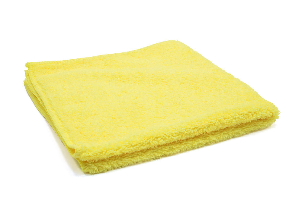

        Oh here we go! I just did a quick search for the cloths and I think I found the brand name. I use Uber all purpose microfiber cloths. Here is what they look like.
        Uber All Purpose Microfiber Towels Now in Blue, Green, and YellowSize 16x16This is our all purpose microfiber towel. This is great for door jambs, interior cleaning, even buffing! The "Uber" All Purpose Microfiber Towel is safe on glass, paint, clear coat, and any other surface. For general cleaning your car even in your home, you can't beat it.Pick up more and save more! Update:  Your favorite Uber All Purpose Towel now comes in different colors: Blue, Green, and Yellow. You can now color coordinate your uses for the Uber All Purpose Towels, use Yellow for interiors, Blue for polish and Green for jambs....you choose!  How to Care for MicrofiberTaking care of your microfiber products is pretty easy, there are just a few things that you should remember to keep your products effective and long lasting. You can wash and dry your microfiber products in your household washer and dryer, with warm water and low heat.To keep your microfiber "like new":* Do not use Bleach * Do not use Fabric Softener * Do not wash with other cotton products.Microfiber products do not like bleach, bleach breaks down the polyester and polyamide micro-filiments, rendering them less effective. Fabric softeners provide a layer of "softeness" on your clothing, which is nice for clothing that you wear, but this coating clogs the microfibers, rendering them less effective. It is not that microfiber products do not like cotton products or other fabrics, it is that when you wash your cotton products with microfiber the microfiber products grab and hold onto the lint that the cotton produces. So if you do not want your microfiber towels to lint then you should not wash them with cotton products.Some users of microfiber, automotive, janitorial, need a more effective way to remove dirt, grime, oils, and etc. from their microfiber towels, and Household detergents just don't do the job. Many users like to keep their microfibers in prestine condition, for this there is the original Micro-Restore Microfiber Detergent.
        But as I said earlier I mainly use them for the initial "hard work" of removing the wax and so on. I then use the Meguiars supreme shine cloths for the final buff. But if you all see any problems with the uber cloths please call it to my attention. I may need to change brands or be more careful with them.
        Also, how do you know if a microfiber towel is worn out enough to stop using it? I've had some of these for like three or four years now.

              Those MF towels look fine to me but perhaps you should try changing to the Meguiars supreme shine cloths for both the initial wipe and the final buff, and see if that makes a difference..
              How do you wash / dry your MF's?
