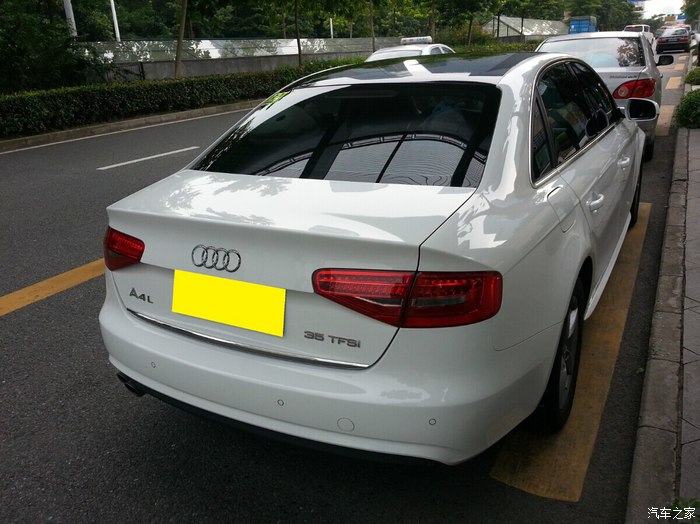

    Hi guys... my car is AUDI A4L bought in year 2012. the color is white... recently what confuses me is that I am not sure if I need to polish my white car yet... actually most of the time I dont even notice my car's swirls, but it does have very fine, not obvious ones)... the problem is that in the direct strong sunlight, or some direct light they are still observable, though not obvious. and I am wondering if I still polish my car (I think I just kind of obsessed with it)... and there are some of the photos of my car for reference... actually the swirls cannot be seen by photos taking, even it is hard to find out unless I find it so carefully.
    Actually I am using GC wash, ultimate wax, collinite 845, cleaning time with meg's white wax and clay bar... By the way, can white wax remove fine swirls?

    White wax can remove swirls if worked in well, usually by machine.
    Will you be working by hand or machine?
    If you want to remove the swirls, then yeah, some kind of polishing would needed. Probably would need Ultimate Compound if working by hand to have a chance...

      I too have a white Audi. The paint on that (and on Audis in general) is pretty hard. Not saying yours is necessarily the same, but if it is, you'll need at least UC and a DA to remove the swirls.
      And yes, WW does have correcting ability, so it may remove some of the really fine swirls. That may be good enough, given the car is white and the swirls are hardly noticable.
      A test spot is your friend!

        White is one of the hardest paints to correct. They are great because they hide a lot but when it's time to do some sort of correcting you have to move your head and play around with the angle and lighting. I highly recommend you get yourself a nice LED flash light to help you out.

          Thanks for u guys comments! I am so glad to collect ur ideas within a very short time. Actually I do everything just by hand; i do not own that kind of machines. That's why i have just browsed the forum again and again, and heard so many ppl said that using ultimate polish is not gonna work, by hand, i mean. I think i am gonna go get a UC and get a try with it. So I dont know to do UP after doing UC right? I dont wanna get too much products when they are doing the same jobs.

            Good idea starting out with UC in this case. Doing it by hand is going to be a lot of work, so you may want to do it slowly, say one panel at a time, when you have time.
            Generally, you would then apply UP after UC, but it depends on what the paint looks like after UC. You may think it does not need UP, or it's too much extra work for little gain (especially being a white car). After UC, do a test spot with UP and see if you can notice any difference, and then decide from there.
