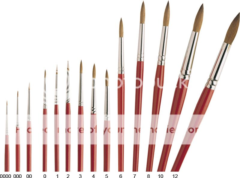

                        I have been looking at getting a couple brushes but somehow always lose the motivation on that one.
                        Mike if you are still around, do you remember the size of the paint brush?
                        I don't know if 0 would be too small and really am stuck on what size to get.
                        At about $8.00 for an artist oil brush, it would be helpful to know if sizes 0 thru 2 or 4 are ideal.

                            Re: Chip and scratch repair
                            As finer of a brush as possible for the chip scratch size.
                              I know but all scratches are not created equal.
                              Like I said they are not cheap to make a guessing purchase.
                              Maybe a 00, 0, or 1. Ideally I would get a couple of the ideal size. The 0000 looks to have 2 bristles.
                              For interior painting I can use a 2 1/2" or 3" brush for 'everything'. It has to be the best brush, Wooster or Purdy do.
                              I don't really want to buy a whole set or a bunch of baby brushes I will never use with detailing money.
