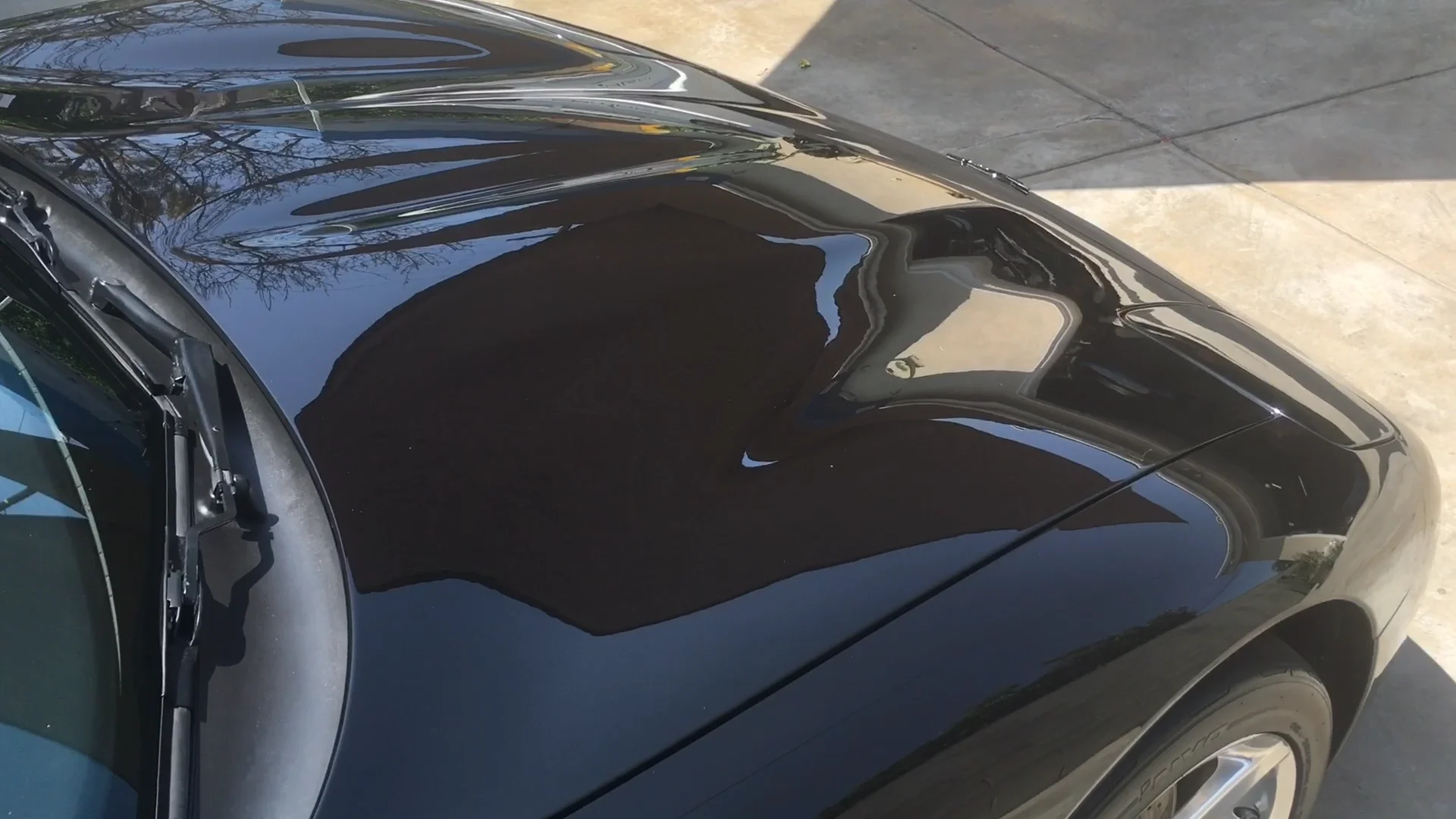

Here are some final photos to show off the end result. I had some dust on the camera lens.
He got his new plates
No palm tree in the back of the house. Sorry to disappoint you Ron but this as close to a Merlin shot as it`s going to get.
2 coats of DP Tire Coating
Beautiful defect free paint
The paint came a long way from this
To this
There are still some deep RIDS left. I am not going to chase them down. There are also some leftover sanding marks from the body shop. The good thing is that they are in areas that are not visible. The lower rocker panels under the doors have a lot of orange peel. It is not that visible so that is a good thing.
The transformation is night and day.
